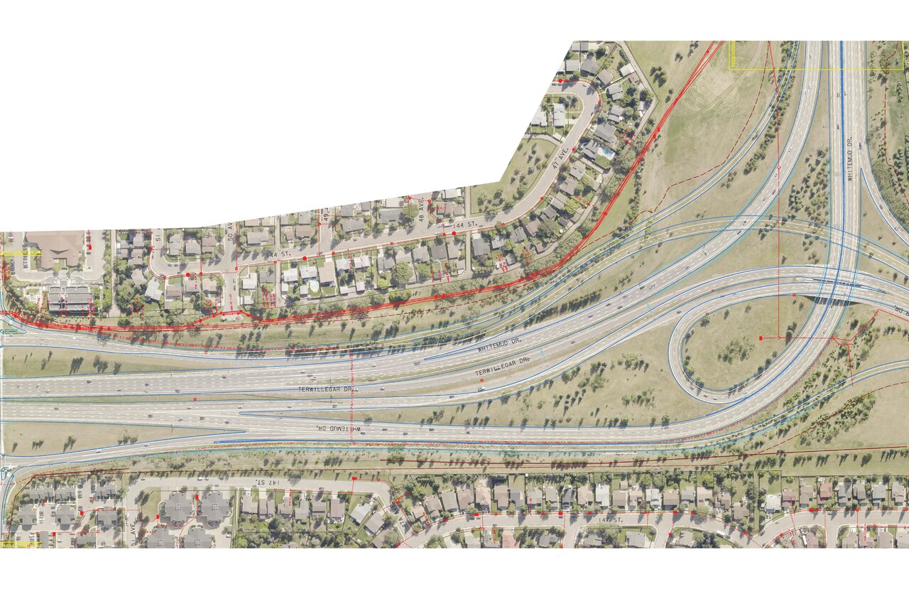

Some interesting changes to the Terwillegar-Whitemud interchange. Now a dedicated BRT ramp from 53 AV to Terwillegar SB, 2 new bridges for NB Terwillegar to NB Whitemud.

I was told these plans are an ultimate configuration and what gets built depends on funding from higher levels of government, so unfortunately those new northbound bridges to make the Terwillegar merge on the right hand side may not be built at this time. This is dissapointing to me as the current configuration is dangerous and unconventional. All BRT facilities will be built, so that is at least good news.
