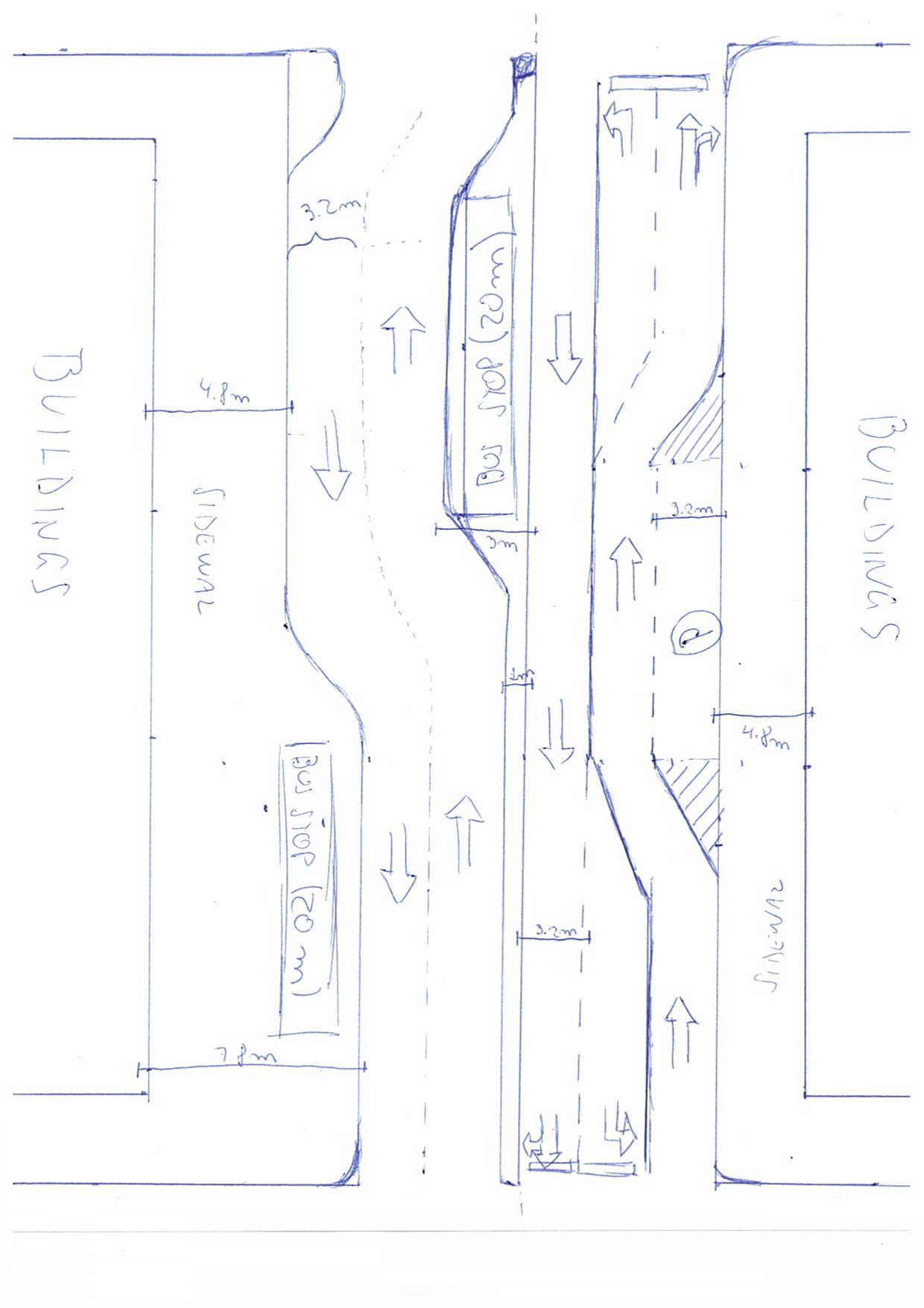

I made a pretty poor sketch of what I think Jasper could look like, using measurements from Google Maps for width. The typical block is actually a lot longer than my A4 paper allowed me to draw (roughly 100m, not 40m as this scaled drawing shows).
This would provide for roughly 70m of street parking every block, 60m of 7.8m sidewalks on the north side of the street, with the other 40m and the south side having 4.8m of width. The road would also have a 1m median and turning lanes.
There would be 1 car lane in each direction and 1 bus lane, completely segregated in each direction, in what could be a BRT corridor.
I'm not an urban planner or an architect, by any means, so if there's something really wrong and unfeasible, please, educate me on that, I would love the opportunity to learn.
@archited Jeez, it may not be a city planner level diagram but at least he put in the effort to demonstrate his thoughts and ideas to us....
Good going @ChazYEG , I think you've got a real neat idea there. The only thing I'd suggest is to get rid of the on-street parking entirely from your block on Jasper, because then traffic would flow just that much easier ;)

@archited On the right side of the drawing (which would be the south side of Jasper) you have one lane on each direction + turning lanes and parking, on the left side you have 1 bus lane on each direction + a really large sidewalk. That's the summary.
The sidewalks would feature 4.8m from the current 4m, on the south side and 7.8m on the north side.
@Platinum107 thanks for the feedback as well, I left the parking, there, as a way to prove that we could still have it, at least in a first moment, and have enough space for larger sidewalks and dedicated bus lanes, in a way that's favourable for business in a city that is still too car centric. As time goes by and the area becomes more transit and pedestrian oriented, we could get rid of parking and turn the space into larger sidewalks.
And btw, I only thought of this for the stretch from 109st to 124st, as I'm not sure it would be a great idea for the downtown core to have Jasper set up like this (on the other hand, I don't believe there's need for on-street parking there).
Only two driving lanes, with two dedicated bus lanes? The bus lanes will be mostly empty and the driving lanes will be jammed full of frustrated drivers. I like the outside the box thinking, but practically speaking that's a terrible idea.

We currently have only two driving lanes and no bus lanes and, yet, it's hardly jammed full of frustrated drivers, even though the buses frequently stop and slow the flow, take that off and I don't see a big problem there.
I drive through bit every single day, both ways, different times of the day, rush hour or not, and it rarely takes me more than 5 minutes to go from 121 street to 109 street, even with all the construction, bus stops, etc...
Also, the idea would be that the two segregated bus lanes, would be part of a BRT corridor, not regular bus lines, which would make it not only busier, but also more useful for whoever lives within 2/3 blocks from Jasper, in terms os transit.
