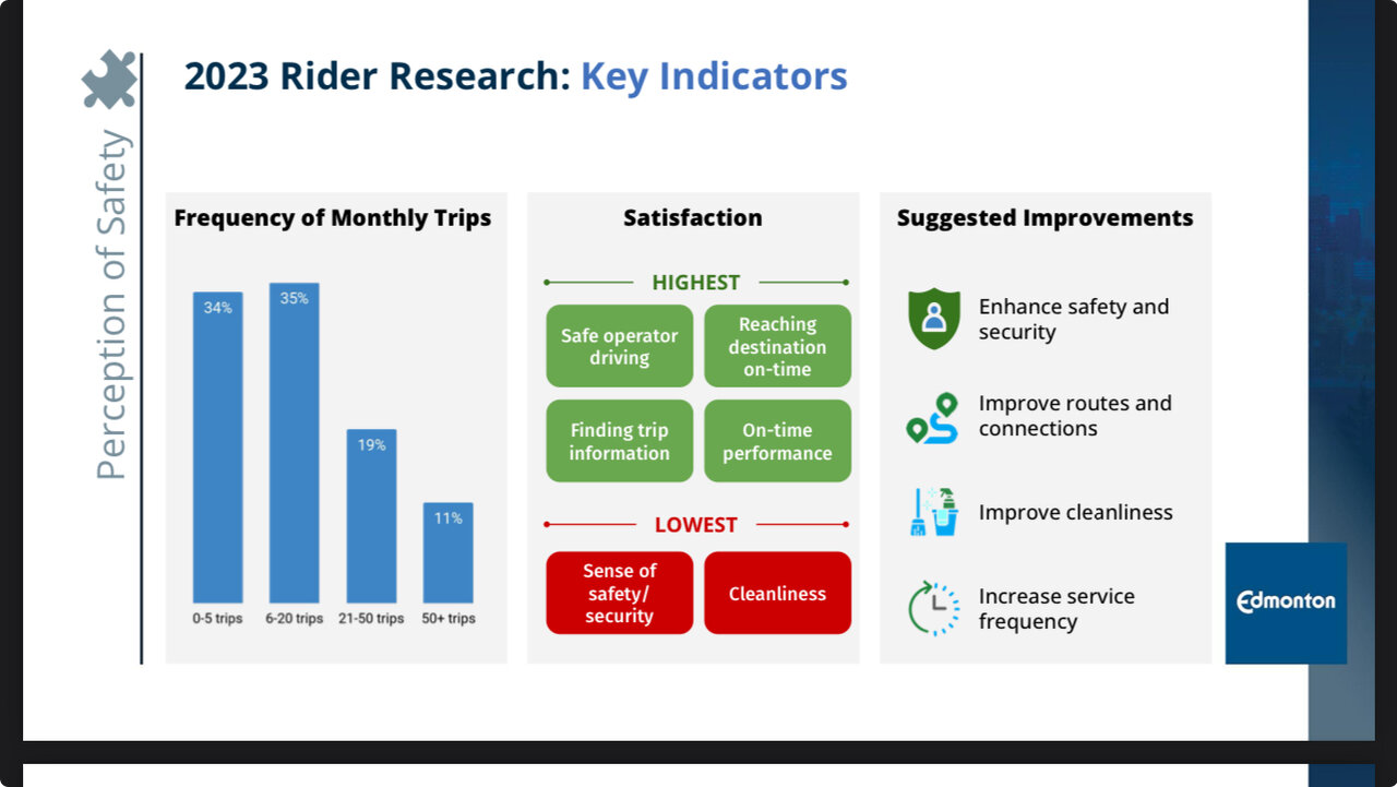

ETS surveyed 3000 riders last year.
Only 15% of riders choose ETS because it’s convenient.
As expected, Sense of safety/security & cleanliness scored the lowest & increasing service frequency was suggested.
