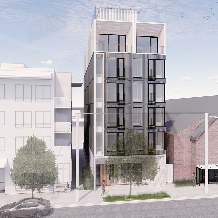

Does this include anything similar to Seattle's single stair rule? It would allow units like this to be built. Neighbourhoods like Oliver would be great for these.

Does this include anything similar to Seattle's single stair rule? It would allow units like this to be built. Neighbourhoods like Oliver would be great for these.View attachment 507145
My understanding is that the stair rule (single v double) is part of the building code, not the zoning code. So i don't think the new zoning code addresses that.
I agree, I'd like to see it relaxed for small apartments, and I wonder what the best method is to see that outcome? Because Edmonton doesn't have our own building code like Vancouver does, it would require a modification to the National Code, or just for Alberta? I don't know, is the city allowed to grant an exception to the building code?
^ AFAIK despite the City of Edmonton being the authority having jurisdiction to grant building permits within Edmonton, they cannot enact municipal bylaws that supersede the Alberta Building Code (which supersedes the National Building Code within the province of Alberta outside of federal properties). So they would require a variance of some sort granted by the province.
Now might be the time to make a push for this to change with housing affordability being a bipartisan talking point.
If this was a central point in Calgary’s new housing measures they just announced, it probably would happen on the provincial level.
