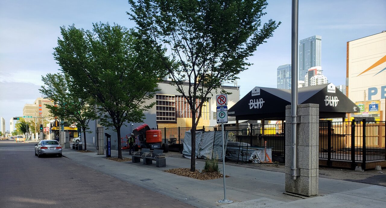

Orange Hub development (156 and Stony Plain) was proposed today at EDC. It’s a 3 storey structure with a “community space” on the main level and parkade on the upper two levels. The structure will be wrapped in chain link fence that is proposed to have public art on it. Artists in San Diego and Tokyo have done beautiful work with this actually as presented at the meeting.
EDC was thoroughly not impressed with chain link as a material choice so it will be interesting to see if they pursue it further. One member said it looked like a correctional facility. Contrary to some of the jokes on here about them being gentle to applicants - they definitely do not hold back their criticism.
