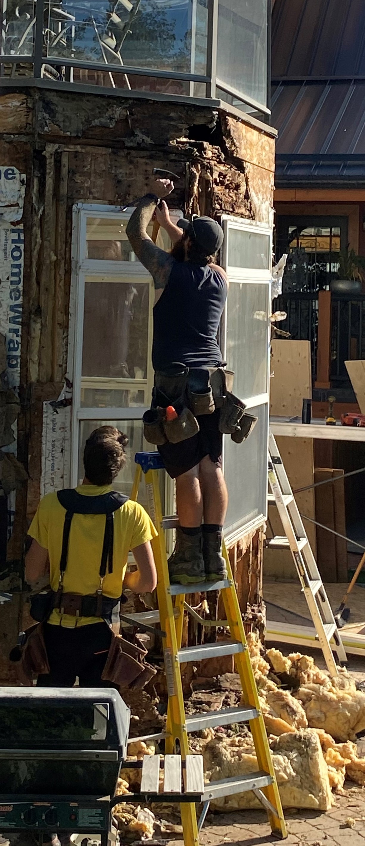

this one is less than 15 years old:
i guess that's what happens when you just screw the baseplate down through the membrane and leave... :(
@kcantor Yikes, where was that?
it probably doesn't really matter where it is but it was an addition done to an infill done by a builder with a reasonable reputation then and now... it was built at a time 15 years ago when all you needed in order to be hired was the ability to fog a mirror. the deck railings are fastened through the membrane and from what you can see it looks like none of the flashings extended enough to keep the water out. it's also a pretty good example of what not to use for material in some locations in an exterior wall and how not to use it - the osb edge beam seems like it might have been framed "inside out" for it to have just rotted away like that in a location better suited to solid timber. but what do i know, i'm just a dumb developer. :(
Water damage to new buildings is becoming very common, my house which was built in 2003 has water damage around the bottom of the back door, I will be getting this fixed before winter comes. Prior to that, the windows sprang leaks whenever rain hit the house at an angle, I got that fixed last year. At least what ever water damage that has happened so far are contained in very small areas. My neighbour had water damage that if neglected could have compromised the structural integrity of the entire house.
