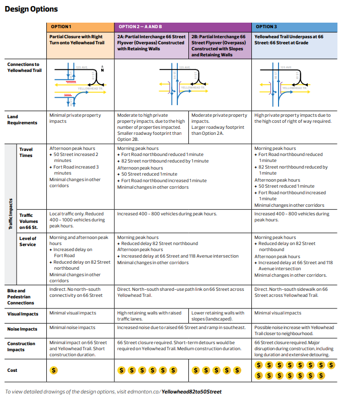

Honestly I don't really get this alignment for 66th. So now there's no access to the YHT (except for that EB road that I'm guessing eventually merges into the YHT?), but they're still going to build a flyover for 66th? That's going to run over $100m guaranteed. Seems like a lot of money just to keep 66th st continguous--how much of a major corridor is it really? Especially when they just spent a whole pile of money widening Fort Road which is a stones throw away. I think the 149th model would have made way more sense which is what I'm assuming @husky was referring to.
Yep, it's this ramp here.
It looks like the city explored that really early on, they talk about it here.

I'm of the same mind. If they want an overpass, just leave it at that. A right in/out on a freeway?
Fort Road is a grenade launch away from this overpass. Save some money and just get rid of the right in/out.
Not an insider or an expert, but pretty sure the access they left for 66st is so there's a close alternate if Ft. Road access is disabled, or needed to be closed for major overhaul work.

I think they should have made this just as straight flyover with no connection to Yellowhead at either 66th or 61st and just leave the 125 ave connections to 50th and Fort Road. But i suspect that the screams of the business owners was what lead to the current compromise. And that single east bound direct connection of 66th and the right in out on 61st was the only ones they have room for without buying out a larger number of property owners and/or creating a merge hazard. I also suspect that cheaper land buyout costs and even louder screams about lost connections was the reason that 66th got a flyover and 149th street didn't.
