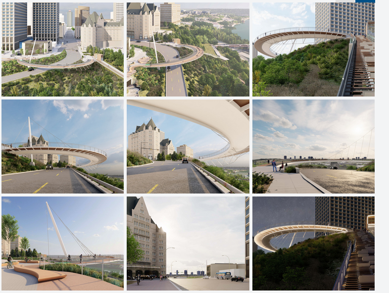

McDougall Hill Pedestrian Bridge
City of Edmonton – $529,875
Reinvent an outdoor space by creating a pedestrian-friendly area on MacDonald Drive that connects the Edmonton Downtown area to the city’s river valley.

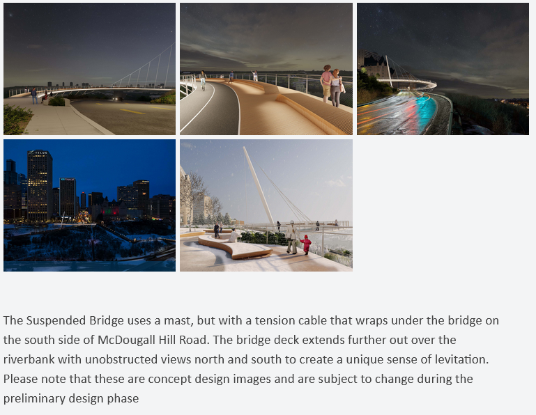

This is a brilliant bridge design -- the structural engineer who conceived this warrants an ovation. And it is not going to be easy to build. There will need to be a double-arced post-tensioned ring around both perimeters (inner and outer) to create a stable platform that can then be cable-stay suspended. It is going to have to be braced in place while each portion is post-tensioned during construction. A to-scale model will also have to be built to have wind-tunnel tests verify that this bridge will not be subject to "galloping" wave-forms in a high-wind event. My main hope is that the City doesn't "chicken out" through the process of what will prove to be a fairly expensive design and construction process. This will become a prominent Edmonton landmark and that should remain the goal!
