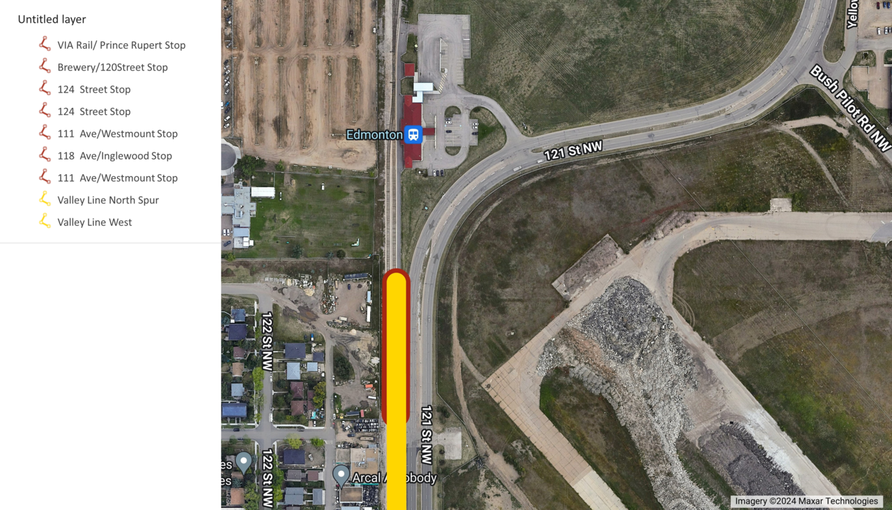

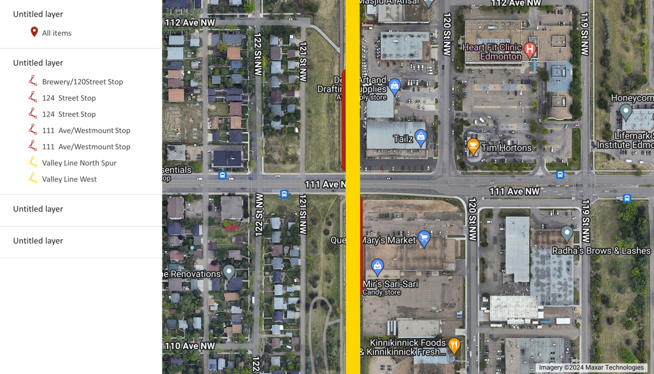

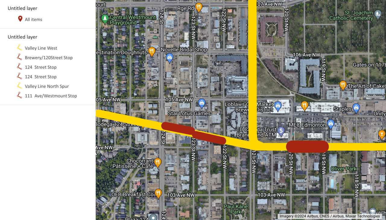

This is what I have been imagining. My apologies for how amateur it may be, I just slapped it together quickly. Starting at Brewery District along the VLW alignment, Terminating the Spur at the VIA station.
What we're looking at is a branch line that feeds to and from downtown. It could terminate at MWTC, or anywhere else in between. More complex switching is possible to allow for connection to this spur from the west, but I don't see the point since you could simply transfer at Brewery/120 ST or the Yards/116 ST.
I would recommend identical wire fencing to the Metro line in Blatchford along the majority of the alignment due to the proximity to the park and MUPs. Pedestrian crossings would share the design of the Metro expansion in Blatchford.
My preference for stops would be far more bare bones than the current Valley Line. For cost reasons, I'd recommend what is essentially a raised sidewalk with benches and wind shelters with timed wave on heaters.
Concrete sleepers on a standard ballast would be preferred for the majority of this alignment. Concrete embedded tracks would be ideal for all street crossings, and the 121 St section next to Brewery.
This extension would very realistically cost $150-250m. It would serve a large amount of apartments that line 124th street, it would solve the much needed connection to the VIA station, and it would allow for future expansion across the Yellowhead along a similar line to the old tram.
I really like the idea @Habibfazil had about an Intercity bus station. Obviously ETS could terminate some routes here, but inviting Flixbus to stage their pickups and dropoffs at this location would also be a positive.
I think the city could receive significant money from the feds and the provincial government for this. Especially if they sold this as a commitment to regional rail, which is Smith's brightest spot IMO.
Thanks.
Edit: I clicked on the link that @EdwardEdm posted after making this. It appears that I just recreated a new version of the Northwest Line from the old planning documents.
View attachment 580730View attachment 580731View attachment 580732View attachment 580733
Thanks.
Utilizing the 121 street alignment is a great idea there is a lot of possibility for redevelopment. The biggest problem is the VLW will need all the capacity it can get. It makes little sense to run a five minute frequency to MWTC but not WEM. If the corridor was developed the train should run all the way down 121 to Jasper avenue then possibly east to 95 street and north to 118 avenue.
I think the increased frequency to WEM could make more sense, but higher frequency downtown seems more important than on the West End. I'm also trying to keep switching reliability in mind with this instead of a complicated union.
This line would most likely run at a 15 minute frequency?
I would love a Valley Line connection down Jasper Avenue from 124th to 109th (ish) since there is an LRT dead zone close to the river right now, I just don't see it financially viable with all of the other planned extensions. The 121 Street alignment would very affordable compared to all other planned, and advisable extensions.
