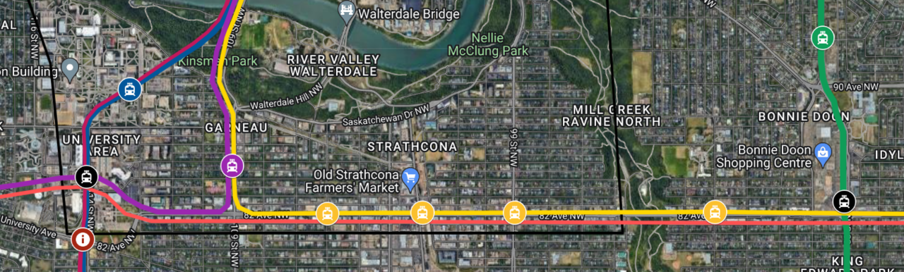

Cool map! I also want a subway under Whyte and here's my idea:
Ignore the 6 lines on the map just pay attention to the stations 😆
BRT will suffice for the time being but I believe the Whyte ave and 124th street metros are gonna happen one day.
This looks great! Are you able to share your larger map with the full proposed metro network?
