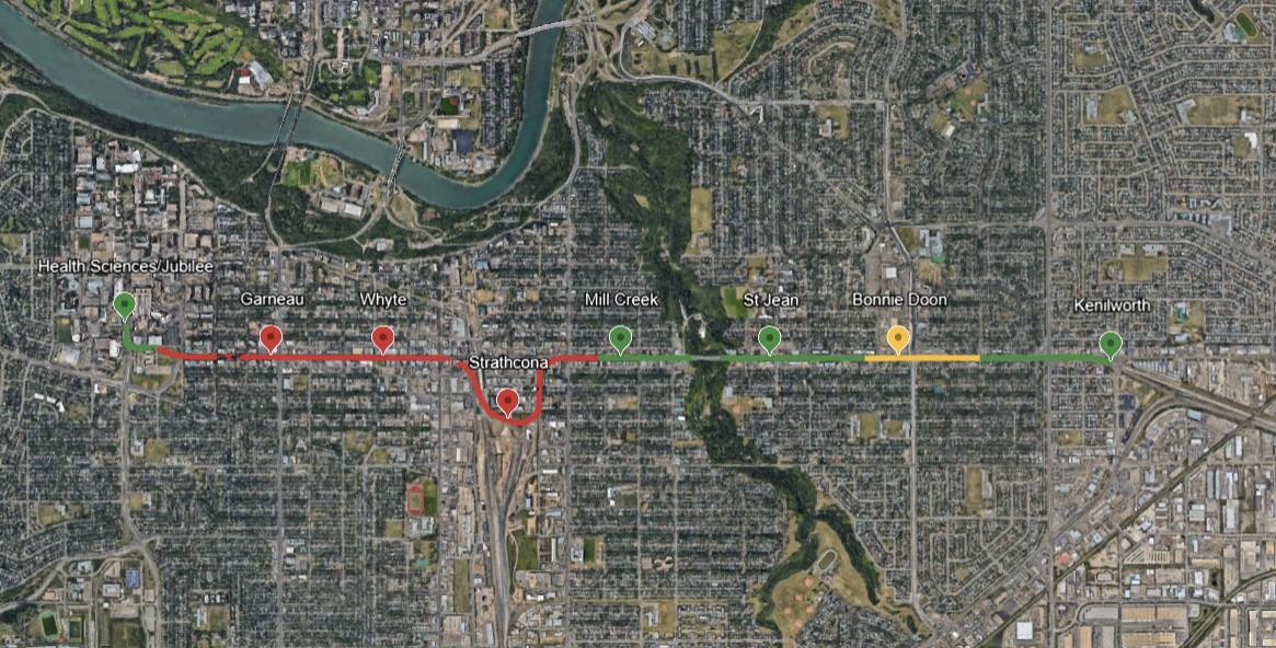

Quick Google Earth Sketch of a potential Metro Line East alignment through Whyte.
Green = At Grade
Red = Underground
Yellow = Elevated
There is a brief at-grade section at the university, followed by a drop into the main tunnel just after Health Sciences Jubilee.
There are stops at Garneau and another stop I've simply called "Whyte"
The route then drops south of Whyte Ave in order to connect with a future regional rail hub at the Strathcona Rail Yards and a potential LRT line in the streetcar alignment. If there was anywhere in Edmonton that a cross-platform transfer could happen, this is it.
It then heads back to Whyte and soon after, exits the tunnel before at-grade stations at Mill Creek and St Jean
Next it heads up a ramp onto a small elevated section to avoid any conflict with the Valley Line, there is an transfer station at Bonnie Doon with the Valley.
It drops down from the elevated section and terminate (for now) at Kenilworth with potential for an extension to Sherwood Park and in particular, Ordze Transit terminal (which just so happens to be my transit terminal).
Green = At Grade
Red = Underground
Yellow = Elevated
Cool map! I also want a subway under Whyte and here's my idea:
Ignore the 6 lines on the map just pay attention to the stations 😆
BRT will suffice for the time being but I believe the Whyte ave and 124th street metros are gonna happen one day.
