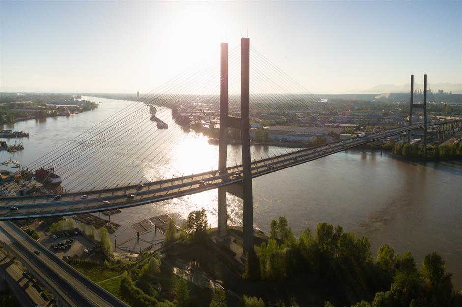

Vancouver has a few that come to mind with the sort of height and span we would need.
Too basic. Needs to be a statement bridge for the next century.
Vancouver has a few that come to mind with the sort of height and span we would need. View attachment 712829

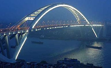

I definitely agree that it should be a statement bridge, but absolutely not a suspension/cable-stayed bridge. The existing HLB deck is 48m high, and you still have to descend from the top if the valley on either side to reach it. Assuming we build the new bridge fully level with the top of either riverbank, it would be even higher and the bridge towers would be ridiculously tall. Underside arches are the way to go imo.
That one’s cool. The Ponte da Arrábida is also a sleek modern bridge but you’re right that we should get a bridge design paying homage to the OG HLB.

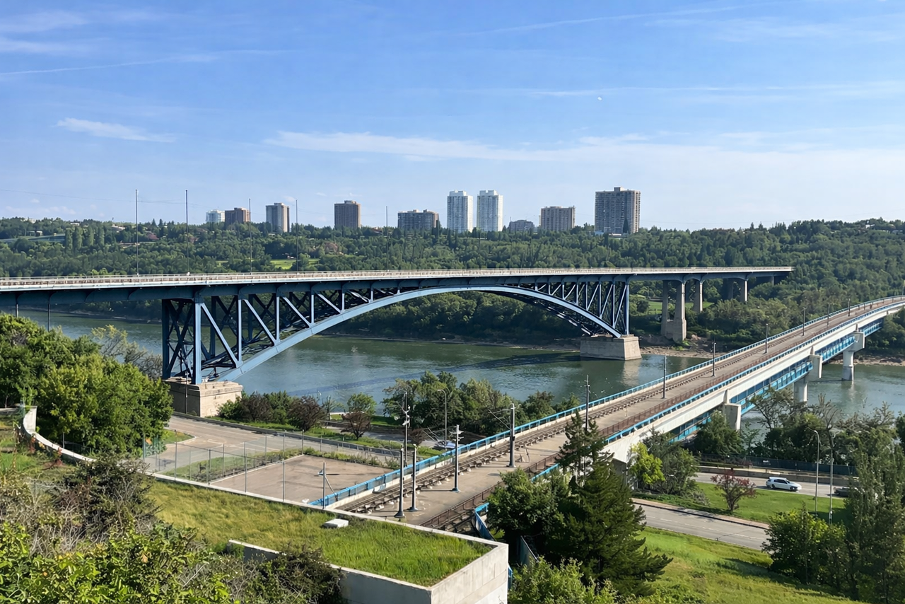

Do love the HLB and it's historic nature but too many reasons to build new that can accommodate larger traffic levels, street car/lrt, & HSR. I'm leaving it up to those that know better that it wouldn't look great having the two bridges visually side by side (plus high level would still need investment). It's also the not trivial to consider the impact economically of redoing the high level and the associated disturbance.
This could be considered in the design process for a new bridge. Some of the examples already posted here, could go very well with the existing High Level Bridge, others would not.
