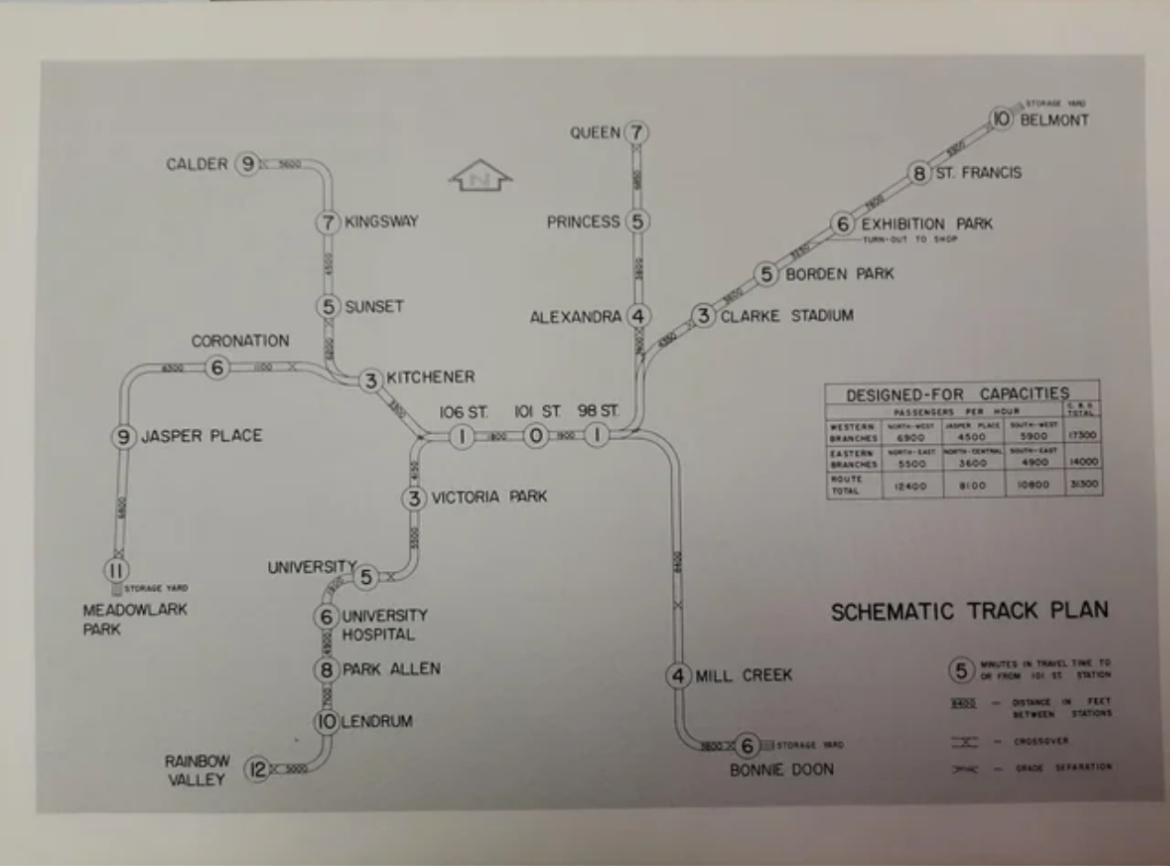

Wow, I've never seen or heard of this plan before! Thanks for sharing @Yeggy

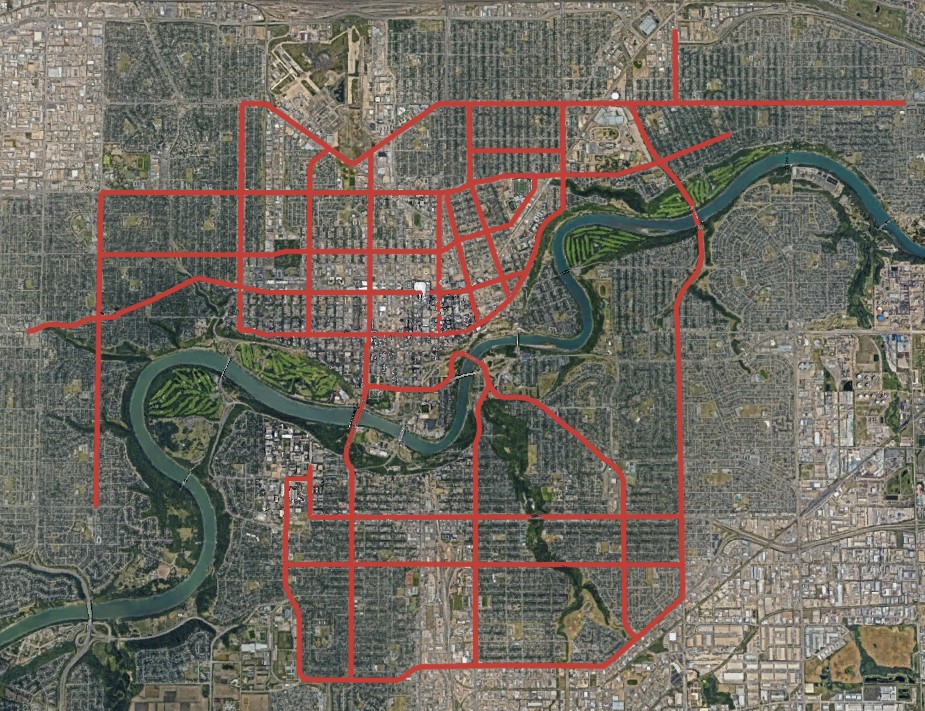

This is (I think) what the network looks like laid out over the city. Very impressive considering the population of the city at the time. It was difficult as some of the street names are different and a lot of them have changed alignments at least a bit over the years. Mainly in the Cromdale Area, where I basically gave up since the road network is completely different.

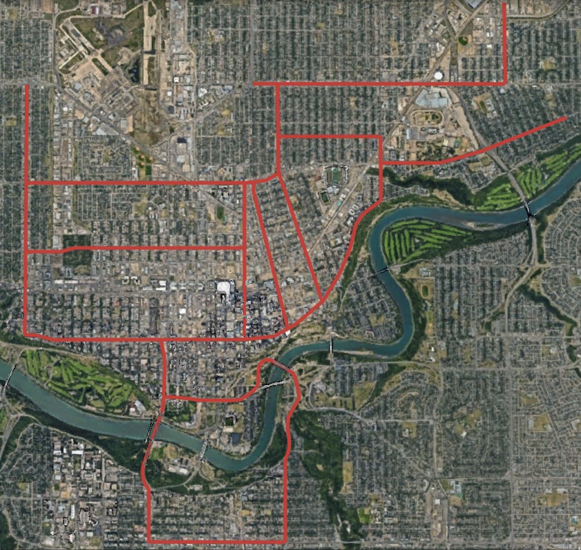

Here's an alternate history map of what might have been if the city hadn't removed the streetcar network, but instead kept, upgraded and worked on it like Toronto or Melbourne.
Woah! Personally, I've honestly never really considered a streetcar network for Edmonton and what it might look like, but this is really interesting. With a network like this central Edmonton would just be such a great place to live, and the density of lines in Boyle Street may have helped make it a more relevant and cared-for area in time, but here we are 😕. Thanks for sharing @erudyk_29 !

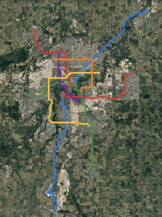

I have updated it with my vision for the LRT, within Edmonton confines only (didn't dabble into the CMA).
Schematic Map:
Explaining every line:
High Floor Lines
Line 1:
Main north-south connector.
It bisects the city in two halves, connecting from the Garrison to EIA.
Length: 44km
Stations: 27
Frequency: 3 minutes
It runs at grade, partial grade separation (like the current Capital line down 111 st) from 176 ave to 127 ave, where it goes elevated all the way down to 118 Ave, where it goes back to being at grade and meets Line 3 in Blatchford, where it shares the tracks for two stations, and goes underground under Princess Elizabeth Ave and continues under 109 st all the way until it meets the existing tunnel, at the Government Centre station.
Between Government Centre and Heritage Valley, it essentially follows the current plans for the Capital Line, continuing down to EIA, where it has 2 stops: 1 at the cargo centre and 1 at the terminal. A few changes are to be made: the whole section between Health Sciences and the point where it resurfaces on 111 St is now underground, Southgate Station actually connects directly to the mall, and the Transit Centre is redesigned to be one massive station, instead of the weird bus shelters.
Line 2 - Northeast - West connector
Connects Gorman to West Edmonton Mall
Length: 27km
Stations: 24
From Gorman to Corona it follows the current alignment and plans for the current Capital Line, with the addition of a station at McCauley. A few fixes are done here: it dives underground the Stadium station until it's past 82 st. From Corona, it continues west under Jasper Avenue, before turning north on 124 st, where it connects with Line 5 (current Valley Line) and then moves back west under 111 Ave, where it connects to Coronation Park and TWOS. It then moves to being at grade/trenched, going SW, through Canora and connecting again with Line 5 in Jasper Place, where it turns west towards Terra Losa, where it goes underground again at 178 st and then finishes at the WEM.
Line 2 - B - Highlands - Beverley extension
Length: 5.5km
Stations: 5
Frequency: 9 minutes
Short extension going under 112 Avenue, starting at the Stadium station and going east through the Highlands, until 50 St, where it moves north for a couple of blocks, and the east again to Beverly. It adds another 4 stops to the line, connecting Concordia University to the system.
The scheduling for Line 2/2-B works in the following way: Line 2 -> 5min -> Line 2 -> 5min -> Line 2 -> 5min -> Line 2-B -> 5min -> Line 2
Line 3
- NW-SW
Connects Campbell Rd and Windermere
Length: 34km
Stations: 26
The NW alignment follows exactly the plans for the current Metro Line, all the way to South Campus station with a few changes: It goes underground after NAIT station, until it crosses 107 ave, where it goes back to how it is today.
From South Campus station, it goes west, underground, adding another station at the west side of the campus and then crossing under Whitemud Dr., adding a stop at Fort Edmonton Park, where it turns south, at grade and parallel to Whitemud, crossing under 53 Ave and continues at grade, before slightly dipping under Terwillegar Dr. SB lane and resurfacing immediately at the median of Terwillegar Dr., which it follows at grade, crossing under Bulyea Rd, Rabbit Hill Rd and 23 Ave, and then going elevated right before Haddow Dr., crossing the Henday and going back at grade through Windermere, back on the median of Terwillegar Dr., crossing under Windermere Blvd., continuing at grade down on 170 st SW until Ellerslie Rd.
Low Floor Lines
Line 4 -
East-West connector.
Connects Baseline Rd and Lewis Farms
Length: 22km
Stations: 21
Frequency: 5 minutes
This is probably going to be controversial, due to my choice of running a low floor line here, albeit mostly grade separated (and underground). The reasoning for this is the possibility of sharing tracks with Line 5 (Valley Line). It would be able to run up to 4-car trains and a 5-min frequency, for the sake of capacity.
It would run at grade, but south of Baseline Rd, instead of median, until it turns south on 50 St, where it continues at grade, east of the road, turning west and crossing under 50 St at 92 ave, where it runs at grade and turns south on 68a St, before turning west again and finally going underground on 82 avenue before 75 st. It runs underground all the way from this point until it crosses the North Saskatchewan river and resurfaces on 87 Ave just west of 142 St. From here, it runs the median until it joins Line 5 and follows west to Lewis Farms.
Line 5 - SE - W
Connects Ellerslie and Lewis Farms
Length: 32km
Stations: 31
This is the least modified one. It is basically the current Valley Line with the south extension down 50 St to Ellerslie Rd. Changes made to this are: closing off a few crossings and extending Davies, Misericordia and WEM stations, to allow for up to 4-car trains, increasing capacity. The WEM stop would effectively connect to the mall, in similar fashion to Southgate, with a massive station that would connect the underground, high floor Line 2 and the elevated Lines 4 and 5 station.

Line 2 (Red): This is the Metro Line, it has also been converted to ALM and significantly extended... It drops down and has one more stop at Kenilworth before entering a long stretch without stations along Sherwood Park freeway, this wiill be the fastest portion of the system most likely. It then enters Sherwood Park, with stops at Ordze, another at Centre in the Park (called Broadmoor), Bethel, and finally Emerald Hills.
Love this map you made, but your alignment for the Metro Line to Sherwood Park gives me quite the dilemma for my own map. On the one hand, your alignment serves every high-density node in Sherwood Park quite well, with the potential to extend the line to Bremner, but it has poor accessibility for King's University (and the nearby offices) or Capilano in East Edmonton.
The alignment I drew serves those Edmonton destinations well (which I think should be a priority, since Sherwood Park's government has shown no interest in being linked up to the LRT so far, while we should also prioritize service to places in our city limits that pay into the LRT right now). However, it then has to take Baseline Road and enter Sherwood Park through the center of town, so it has to pick between going down to Festival Place (which has really nice high-density development and is the civic center of Sherwood Park) and Ordze (which is basically end-of-the-line), or head up to Emerald Hills, which also has lots of high-density nodes, the local hospital and the potential to extend to Cambrian Crossing and Bremner.
What are everyone's thoughts on the alignment LRT should take through Sherwood Park (especially people who live there)? Is it worth just taking the straight shot down the freeway and heading up from the south end of town?
I also had this dilemma a lot, on the one hand, it makes more sense to make the line turn north and head down Baseline so it can service Ottewell and Capilano areas as well, instead of heading through the industrial areas. In hindsight, your alignment is likely better and more likely for that reason, it also would more readily service Bethel which is the main transit node for Sherwood Park. I do like the south Sherwood Park freeway because it doesn't require as much backtracking for the train in order to service the Centre in the Park area, which is like Sherwood Park's downtown and most dense area.
I chose my alignment for a few reasons:
First is selfish, I would have a shorter ride to school every morning since I live right near Ordze transit centre.
Second is more to do with try to service a bigger area of Sherwood Park. If it enters from the south you can service most of the park with a single line, whereas if you enter from Baseline, there are significant nodes to the north or south (either Emerald Hills or Centre in the Park), which would not be serviced.
Third is sort of an expansion on reason 2. As you said Cambrian Crossing is growing up there are will be a new unit of higher density, but also Bremner, which is a planned community just to the northeast of the Park could be serviced as well.
Honestly a perfect scenario would be like what is done with the Singapore Airport for the metro. In Singapore the east-west line splits at Tanah Merah, one segment serves the Airport while the other terminates at Pasir Ris, having used this system it's excellent and with the cross platform transfer at Tanah Merah it's very quick and efficient, not that a CPT is warranted here though but maybe, braching the Metro Line (or Line 2) when it reaches Sherwood Drive, with a secondary branch serving South Sherwood Park and Centre in the Park would be best.
I'm thinking like this maybe

Updated my map with an alternate route for the Metro Line through Sherwood Park and an S-bahn system for Edmonton. Diese Stadt ist ab nun Eigentum der Bundesrepublik Deutschland! (No straßenbahn though :( )
Why the giant U to get to Fort Sask?
I feel like the Sturgeon Line could be straightened out (I realize it follows an existing ROW).
The old bridge into town is gone, so the line has to go way up to the newer freight bridge and backtrack to the old station in the middle of town.
It doesn't have to follow the freight line the whole way though. A new bridge and new ROW could be built. Sorry I know it's your fantasy map, and not mine.
