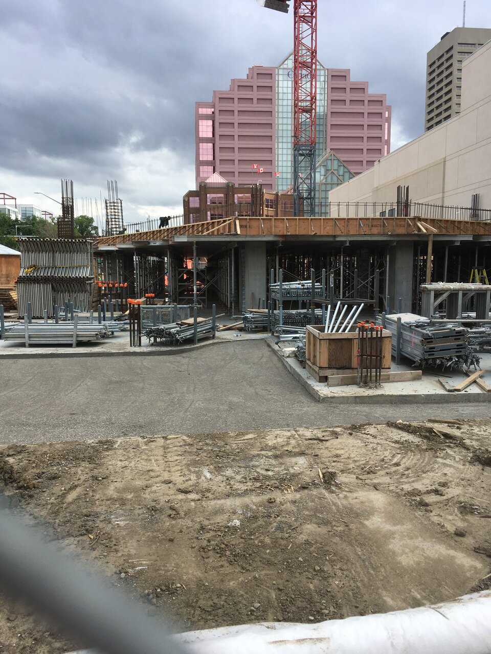

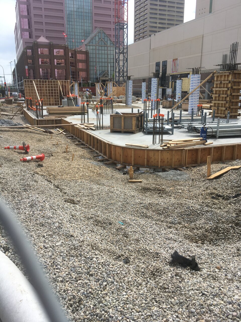

STRUCTURAL FRAME ONLY First level of above grade "superstructure", inclusive of level 1 shear walls, columns, and level 2 slabs. Remainder of building to follow in separate permit submission. Expansion of the existing Winspear Centre for Music building.
