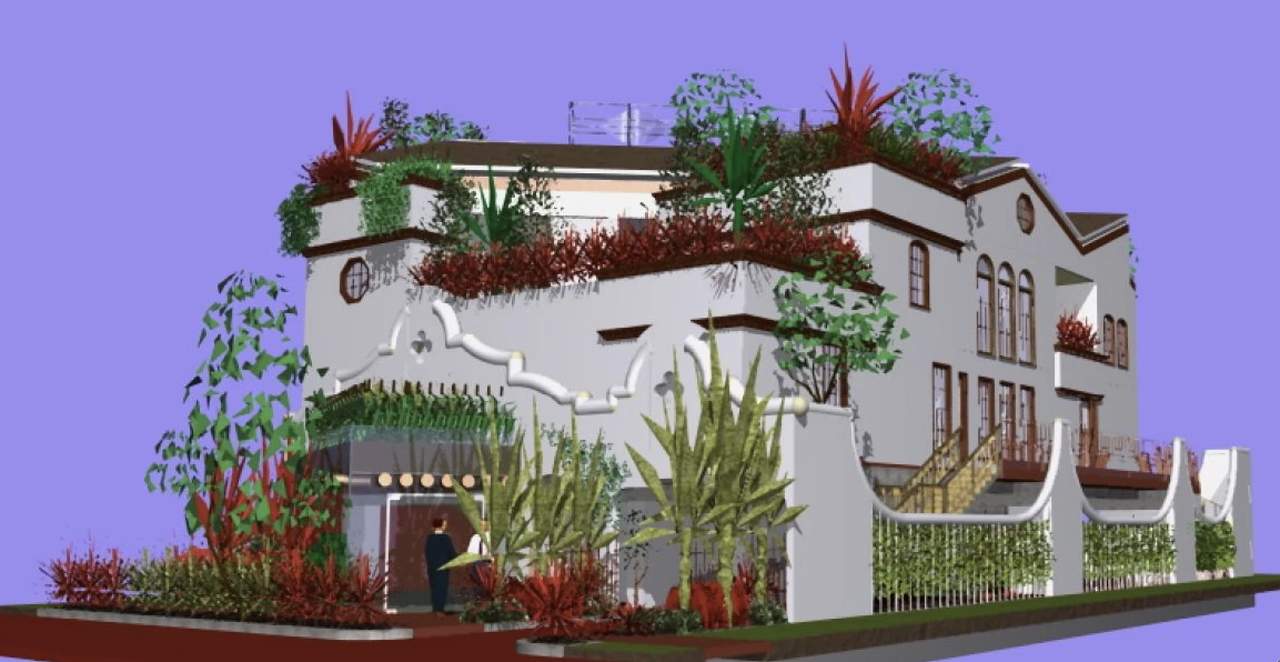

For reference I have attached a couple of projects that I designed using ArchiCAD where CNC played a major role:
The first is a retail/residential project in Santa Barbara -- that city loves conformity to Spanish Mission-style architecture. Though the windows are not close-up in this rendering I think you can see that they are fairly ornate and detail intense -- CNC milled units with R-6 triple-paned glazing (thanks to the California Energy Code going back 8 or 9 years).

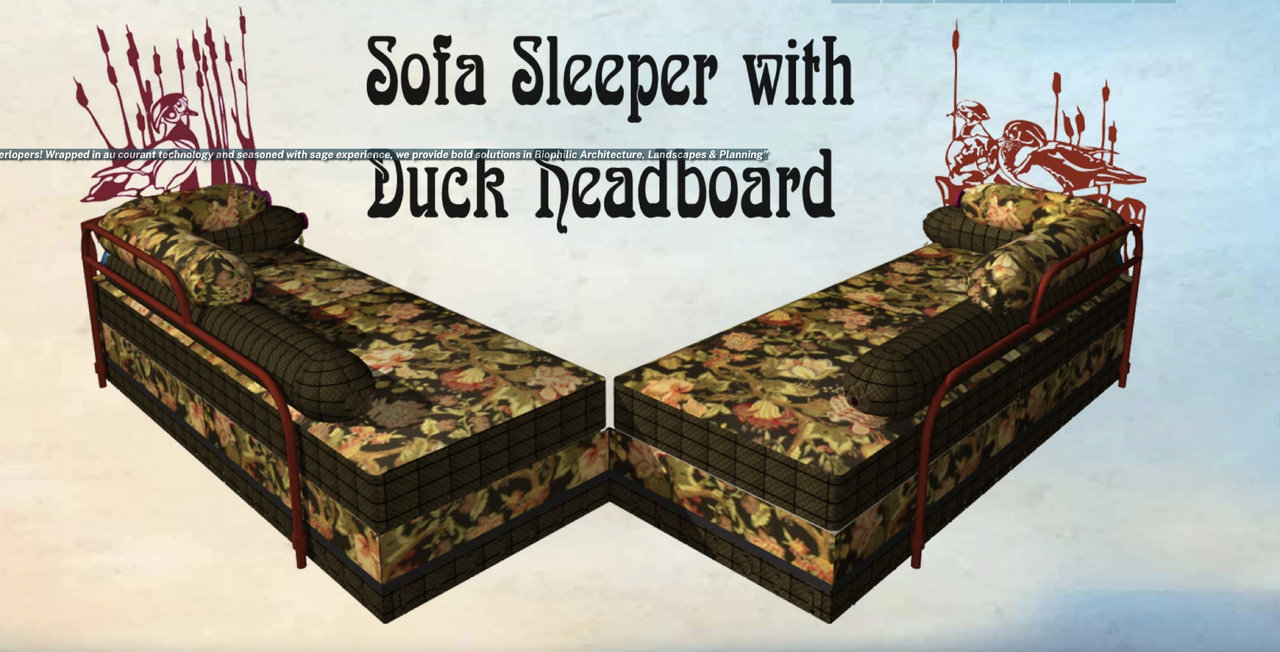

In the area of furniture design here is a custom convertible daybed/sleeper/sofa that I designed -- the headboard is the CNC part. I drew this on the computer (again ArchiCAD) and the pieces were CNC laser cut in about 20 minutes from 1/4" thick Corten steel. The point of these two illustrations is that anything can be manufactured in the present day without the lost art of human craftsman-like cutting, shaping and polishing (snapzed off of a sales brochure promoting our furniture designs). The two units have multi-directional casters and the back-support pieces can be removed and the two sofa pieces then rotated together to form a queen-size bed.
Did someone request that bed?
There's no question that CNC milling improves efficiency. Does it render the time honored principle of economies of scale obsolete? No it doesn't. The average cost of a duck headboard will be less if 1000 are manufactured than if 1 is made because the milling process is only addressing one of many input costs.

(nice job with the headboards btw)
