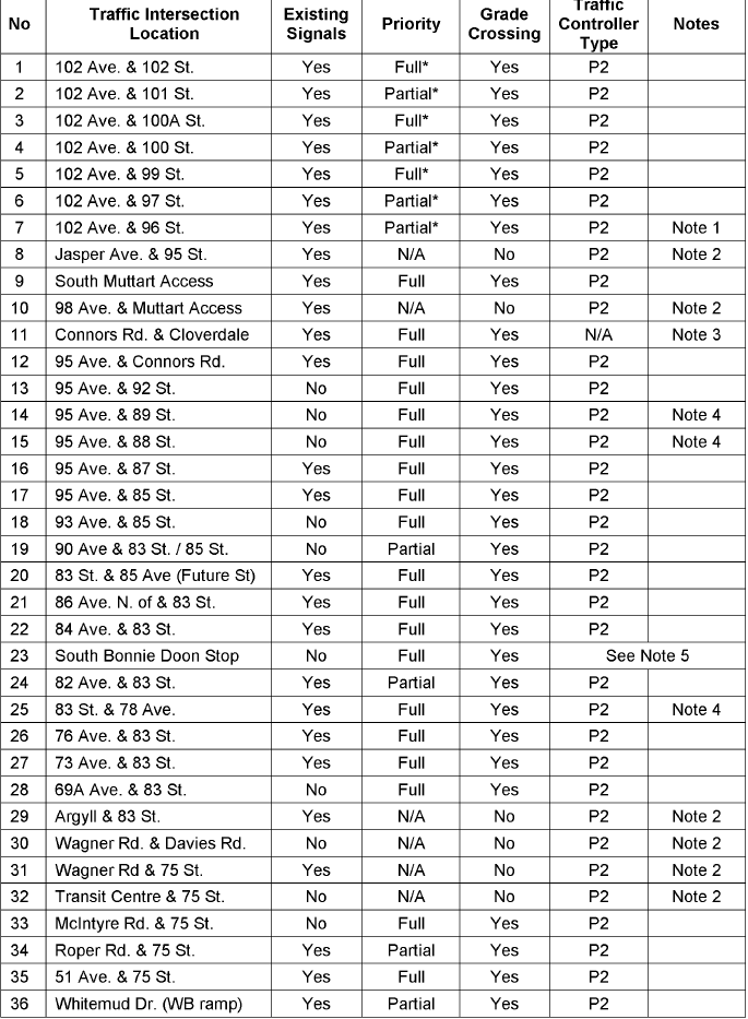

Who says there's no signal priority?
This is such a persistent myth.
It might be implied by phrases like "runs with traffic" that there isn't signal priority, but, you can bet your ass there is. And it's covered in the project agreement.
This link should work: https://www.edmonton.ca/sites/defau...T Schedule 5 Part 6 Systems.pdf?cb=1691910599
Table 6-3.3 Page 6-56 - 6-57.

From the outset it has been made clear that some trains will be held at stations due to the phases of nearby traffic signals, before proceeding on a green light. So trains will not always have signal priority.

"There’s a key intersection at 90 Avenue and 83 Street where the LRT is being given only partial priority over traffic.
That’s where the Bonnie Doon traffic circle is now. The train will have to hold at one of the nearby stations, leaving when it can hit a green light and co-ordinate with traffic."
For anyone who doesn't want to read through the agreement to find it: The line has only partial priority at a handfull of intersections along between downtown and MWTC.
