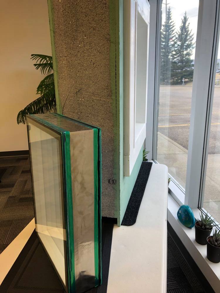

View attachment 349765 This glazing unit by LiteZone achieves R17 at the center of glass, and combined with MagWall's R50 SIP, (shown behind it) Green Violin will have the perfect product for use to demonstrate in our Skinny Townhouse as well as our Pocket House! SAIT is undertaking the testing of the integrated wall that we call the "ThermaVue Transparent Wall System"!
