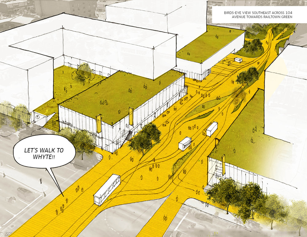

This is not related to the bridge, but these are also important to point out, just to highlight my point about the lack of due dilligence on the part of the HLL people.
^There is  no room for a pedestrian path in the streetcar tunnel, the city acknowledged this in their own HLL-esque proposal from the 90s (they proposed bringing the path from the bridge up to 109 st and sask drive). They made the streetcar in this image half the width of the actual streetcars.
^What even is that track arrangement, and why are there four tracks branching off into a random building?
^More tracks branching off toward another random building? And there's shacks on them for... reasons?
Honestly, the HLL proposal made the streetcar seem more like an art piece than an actual heritage transportation museum/service.
