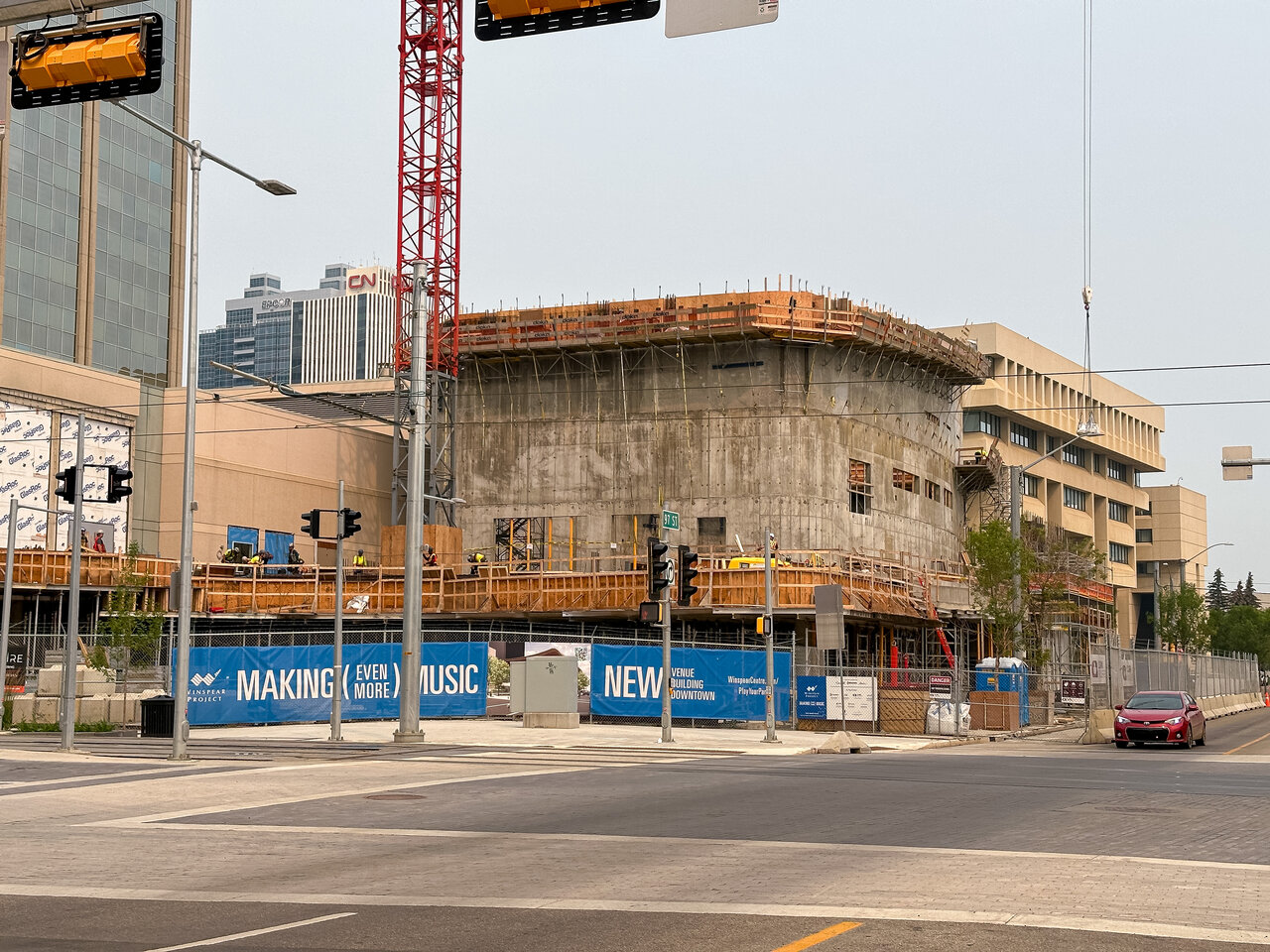

Hopefully we finally see some cladding on this soon…
Some brave soul should go right up to the construction fence (where the information board is shown in the above pic) and take photos of the footings for the exterior wall -- that would be interesting!!!
It is coming along. Every time I go by, I do notice more done, but it is progressing slowly, sure isn't going to win any speed records.
