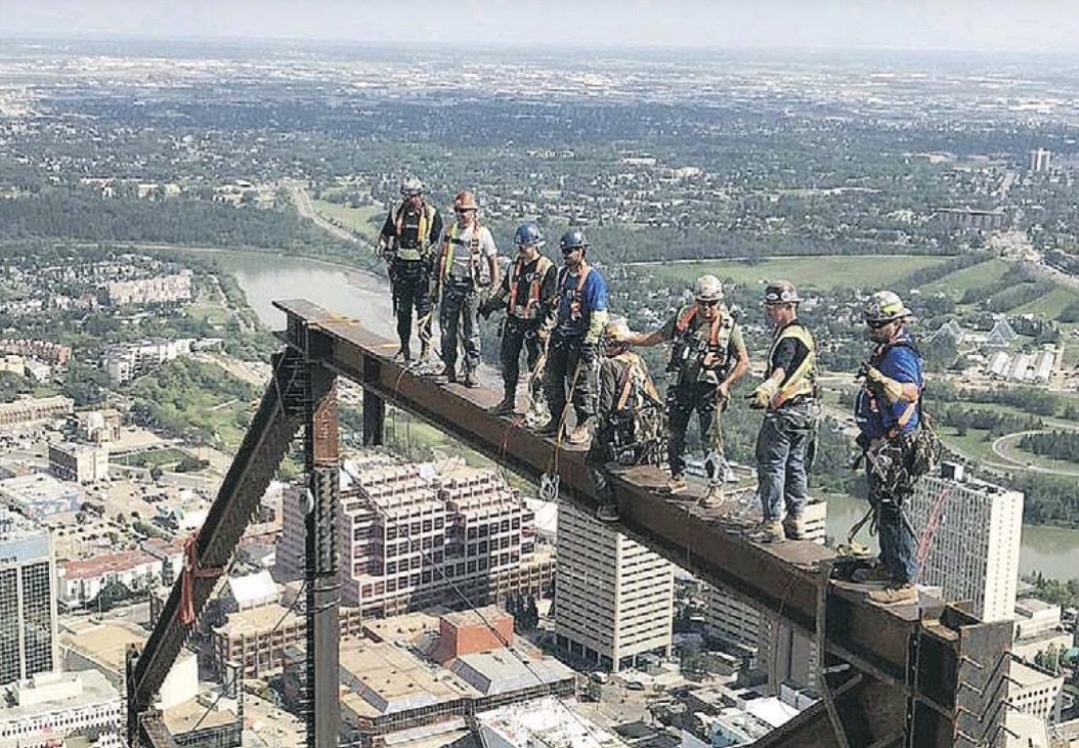

Cleaning up some old pics/screen shots and came across this one.
Many sites don't allow for the distribution of photos unless approved by the GC. These were IW 720 guys, and while I've worked around some and found them to be great at their jobs, the consideration of GC feelings has never been a major concern of the older workers.
My feelings on this photo are the same as the 720 guys. If the people in the office don't like it, walk the steel and take the picture yourself. The photo is gonna happen no matter what when a building like this tops out.
