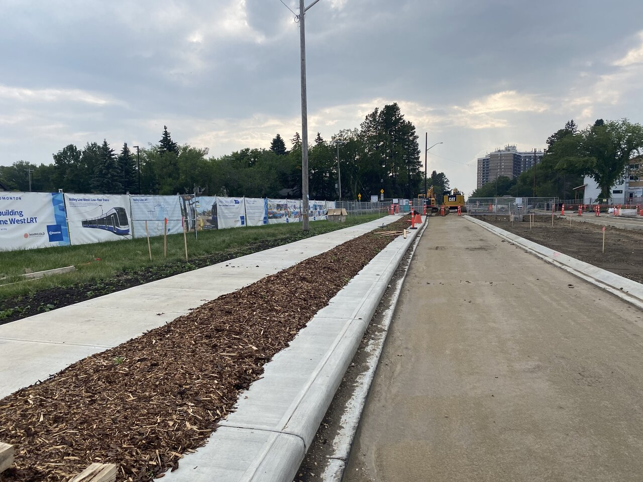

A
Oh great, more mulch instead of grass... Does somebody in City Admin own a mulch company or something? Seriously, they're laying this stuff down everywhere they can lately. It's going to look like crap after a few years.
Agreed. I think their idea is that it’s much cheaper than grass: i.e. they don’t need to have water trucks watering it to maintain it when it’s first laid down and it’s much cheaper to buy in large quantities
