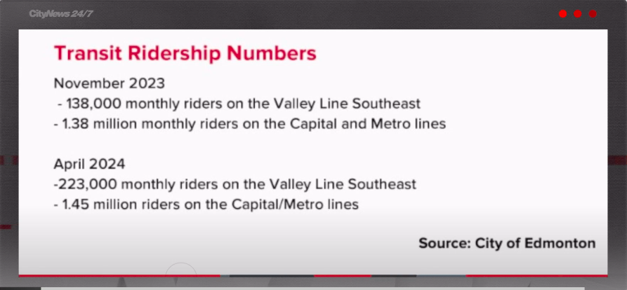

Taken May 31, 2024
Decent growth so far in VLSE ridership.
My numbers based on: https://public.tableau.com/app/prof...CardFebruary52023-April292023/RouteReportCard
For April 2023 the 73 had a ridership of 242,460.
There's still some 19,000 difference between the 73 Valley Line precursor and with the line actually running. It is MUCH better than even earlier in 2024, and much closer to what the 73 had. Could be even a counting discrepancy if the 73 was estimated higher than it actually was. ETS uses automatic passenger counters to determine bus ridership, and not every bus has APC's. I suspect every Valley Line car essentially has built in APC's so I assume that Valley Line figure is quite accurate.
