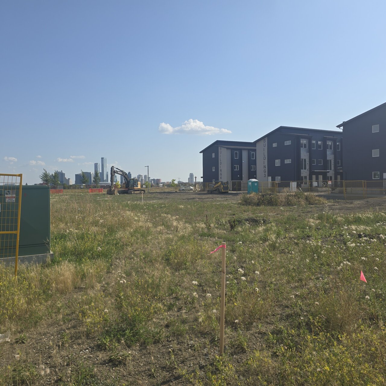

There's still no building permit issued for the EcoDen build, but there's some equipment on-site now. I wonder if the city told them to expect a permit soon?
This is where this one is going?

I'm no expert, but there's certainly a hole that they're expanding pretty quickly. There's at least three dump trucks going between this site and a spot near the aviation museum, where they dump the dirt. There's still no building permit listed for it online; is it safe to say at this point they'll get it? Or is there a risk the city will reject it and we'll be stuck with a pit?
