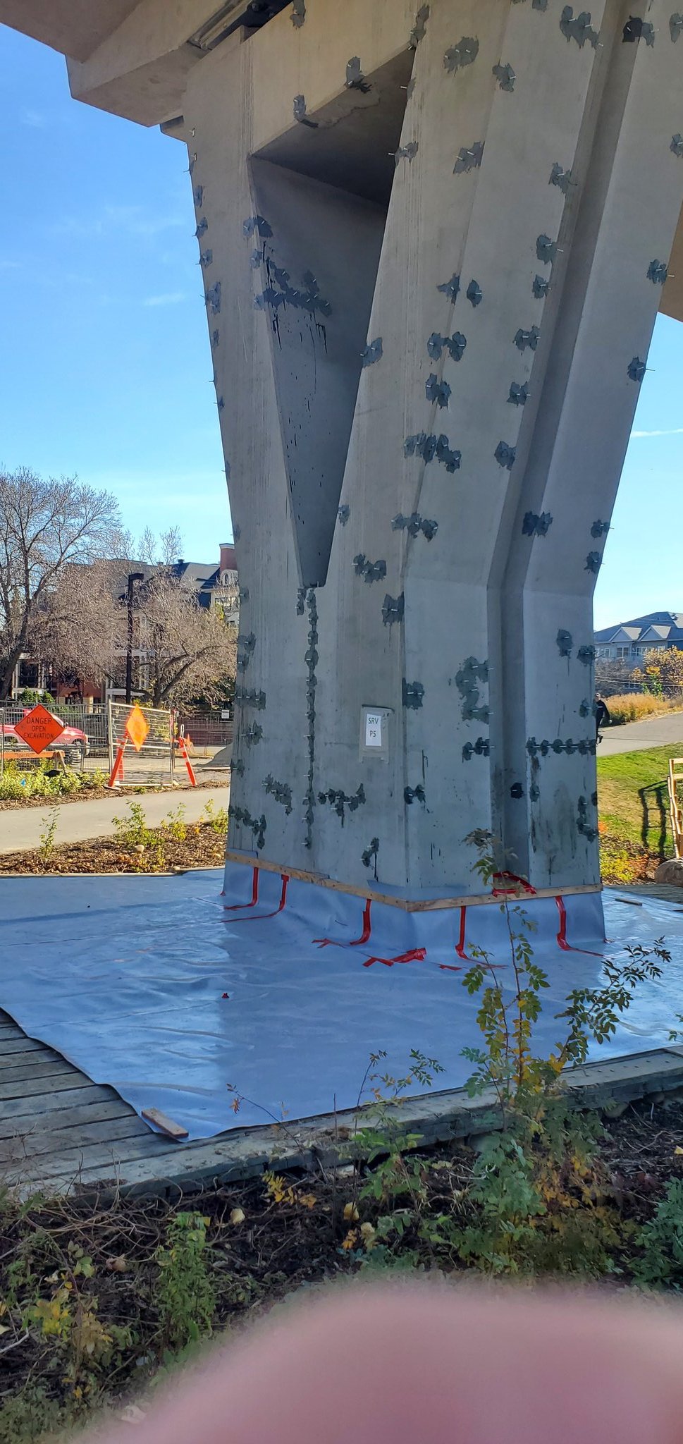

Another one of them nearby (maybe right next to it) is surrounded by hoarding and covered with a rep tarp.
